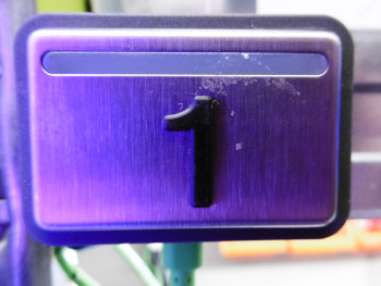

This thing is basically a button that dispenses one sheet of A4 paper when pressed. You can press it multiple times to get more sheets. The button is mounted near the laser printer.
The hardware consists of a former elevator button (1st floor) and an ESP8266 (Wemos D1 mini) with the button (active low) on pin D1.
