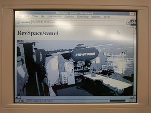

The monochrome screen is surprisingly good. The contrast is great, the resolution is... Very Good Anyway. The lack of subpixels makes it look very sharp. And there is no ghosting at all. I have seen early 90's laptops before where you could draw shapes by moving the mouse. Not this one. There is only one thing missing: color. But it's okay, there is a VGA port on the back, and there is plenty of color in there.

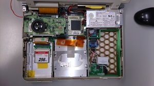

Since the battery is completely dead, I removed it. We now have space to fit stuff in. This space is just wide enough to fit a SHA2017 Badge inside. No joke, it fits like a glove! Well, after some creative OpenSCAD and 3d-printing work that is. I printed many failed attempts in red PETG and just as it was about to run out I did my final print. So I inserted the green PETG in the bowden extruder while the red filament was still in the tube. They print at the same settings anyway, but the layer effect turned out very nice, by accident.

So I now needed a way to connect the Badge sitting in the battery bay to the serial port on the back of the laptop. Complete disassembly was required. I decided to make a second serial port parallel to the first port. This breaks when you connect devices to both ports, so don't do that then!. At first I connected it directly to a MAX232 board, but than I decided to make it removable, just like the original battery. So I yanked a DE9 port from an old desktop board from the e-waste pile and soldered it in parallel to the rear port on a short ribbon cable, snipped away some plastic, added some padding and hotglue. We now have a internal DE9 serial port inside the battery bay BadgeBay™!

Back to the broken fan connector. I spliced the wires from there and from the spring (and later another wire for the OPL2LPT) together and connected those to the pads behind the fan connector. We now have a BadgeBay™ +5V rail!

One of the failed BadgeBay™ designs. The Hexagon grid on the bottom layer was too thin.
