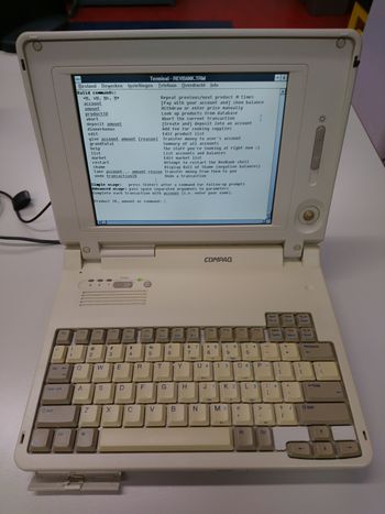

I found this old laptop and I'm figuring out what to do with it. Fun fact: this laptop is almost exactly as old I am.
First impression
Status when I found it
It had the (presumably) original harddrive still present and working (after 23 years!). On it was Windows 3.x with lots of Compaq bloatware and personal data of the previous owner. I decided top keep this as-is, because the original software/drivers/etc is hard to find/replace but I did not peek around very much because of privacy reasons. The battery was very much dead, the floppy drive did not work, and the bottom RAM cover was missing, but it did work just fine. A service manual was easy to find online: Media:Compaq LTE Elite service manual.pdf (2.6 MB, 387 pages).

The first thing I did was take out the original harddrive and go replace it with something else. I went to Aliexpress and got myself a IDE-CF adapter and a 2GB CF card. It could not boot from the card. I borrowed some more cards from another Revspacer and found out that cards up to 1Gb work but larger cards do not. But since the original disk was 250 MB, I decided that 256MB would be enough. I ordered a "industrial" 256MB card and it has been working just fine so far. The original harddrive sits in a aluminium caddy, which is easily removable. That's great, since this is the only way to move files from/to this machine I'll have to use this rather often.

The monochrome screen is surprisingly good. The contrast is great, the resolution is... Very Good Anyway. The lack of subpixels makes it look very sharp. And there is no ghosting at all. I have seen early 90's laptops before where you could draw shapes by moving the mouse. Not this one. There is only one thing missing: color. But it's okay, there is a VGA port on the back, and there is plenty of color in there.

I also ordered a bunch of MAX232 boards and I had some CH340 ttl-serial-usb lying around. So I took one of both and connected them to my modern linux laptop at first. I could get a serial console, run ssh, and even revbank inside the Windows 3.1 Terminal app.
