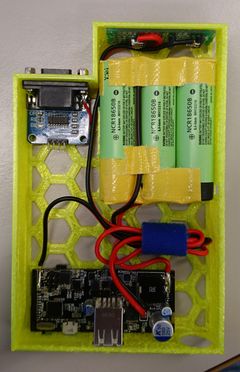

New Battery?
I have decided to replace the original battery with a modern version, based on the Muxtronics Powerbang with 3 18650 cells. This would be more than the capacity of the original battery in less than 1/3rd of the volume in cells. I can charge it using a micro usb port on the front. The Powerbang is programmable and does pretty accurate measurements.
Plans for the future:
- communicate between the pi0w and powerbang over serial (not interfering with pppos, requires either softserial or serial-usb over the OTG port)
- make a web interface to monitor power usage, compatible with ancient browsers
- upgrade to the USB-C PD version which mux might be working on
- maybe add a led battery indicator on the front
- improve usability of the front panel, maybe by making it thinner, and making the shape more like the laptop itself and less like a flat surface
