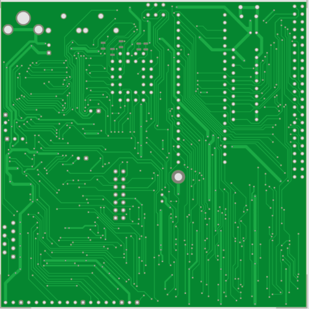

29 DECEMBER 2015
Finalized the revision 2.2 layout, just before year end.
This is how the new revision 2.2 layout looks, note that unlike the previous version I left out copper fills.

Well, the PCB for revision 2.2 of my ZX81 + 35 (35 years after the launch of the ZX81, and almost exactly a year after version 1.0) was finally ordered, and I got an e-mail from Eurocircuits with a preview of the PCB, which I don't want to keep from you.
Top view
bottom view
