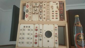

I am currently redoing my case, will probably scrap most if not all modules i made so far, will (try to) do shit properly this time over.
I found some threaded strips at reichelt, and am making a new, lasercut case outta 5mm plywood.
System
Dimensions
  • close to 4U: 180 mm in height
  • module width will be x*5.08mm, this is a semi-standardized unit "hp"
  • Instead of the 2.7mm front panels i planned on using before, i'll move to 5mm wood.
  • The cases will be in slightly less than 19 inch format
  • standard pot knobs are ....... mm in height
Design
  • CV and audio both on banana jacks
  • front panels and pot knobs will be made from 2.7mm or 5mm plywood using a lasercutter
  • front panel design will incorporate icons, arrows and curves to signify what knob/plug does what
Voltages and Power Supply
  • use desktop power supply, optionally decased?
  • 5
  • 12
  • -12
  • Previously, I made a power bus out of bare copper wire with 3 connections (intended for gnd, +5 and +15 v)
  • This was a pain to work with, so i'll probably use the same threaded strips I use for mounting the modules as power bars
  • these strips are available at reichelt
Working Modules
  • Attenuator
  • CV-Source
  • Signal Copier
  • Signal Selector
  • Buttons
  • Arduino stepped oscillator
  • Speaker
  • Amplifier
Not-working modules
  • Sequencer (currently troubleshooting it)
Presumably Working Modules
  • Auduino 2
Work in progress Modules
  • Clock/Frequency Divider
  • LFO
  • Auduino 1
  • Auduino 3
  • Atari Punk Console
