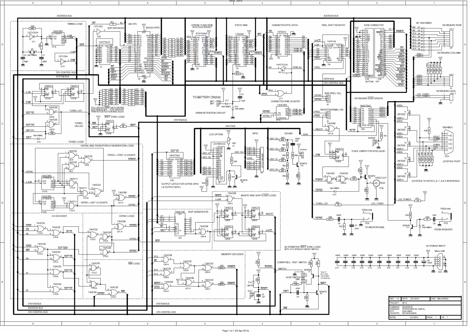

Schematic 81+34
The latest schematic (.PDF) can be found here: File:ZX81+34 schema.pdf
There is also a color coded schematic (.PDF), it can be found here: File:ZX81+34 kleur REV 2.0.pdf.
