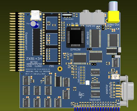

3D Preview of early ZX14

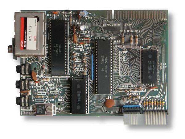

Before I even designed the PCB I made a mockup with Altium. Here are two (3D rendered) previews of the ZX14 board, to the left is an older small preview of the complete system, including how I envisaged the whole system with keyboard would look like, at the center a picture of the more recent 3D rendering of ZX15 PCB, and to the right, as a size reference the original ZX81. Note both PCB's are about equally as tall (10 cm), but the ZX15 is much smaller, as it square, while the ZX81 is much wider than it is tall.

Layout ZX14
Even though I was hospitalized, then immobilized for several months (in the months of June July and August 2014) due to an operation on my leg, I still managed to work a bit on the layout of the ZX14. And on November 25, 2014 The layout work reached 100% connectivity. Here is a preview of how the work was progressed at that time . Clean-up, optimizing and copper filling followed somewhat later. The picture below on the left was actually a screen shot from a gerber viewer of how the board looked in September 16, 2014, note the lack of copper fill to make it easier to follow the connections around. Some weeks later the cleanup was ready, and this is a picture of how the PCB will more or less look like, when it is finished. Note the old PCB layout still had the, now defunct name "ZX81+34".

The ZX15
Finally early January 2015 the PCB of the ZX15 was finished, some last minute changes were made to the silk screen, and some mounting holes were added (needed to mount in an enclosure, and to connect shielding, if you want to add that)
