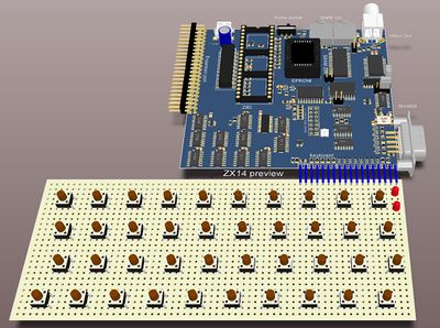

3D Preview
Final preview of the complete ZX14 system, including keyboard. note the small (3mm) power and Turbo LED's
Here is a (3D rendered) preview of the main ZX14 board, to the right a small preview of the complete system,.

Layout
Even though I was hospitalized, then immobilized for several months (in the months of June July and August 2014) due to an operation on my leg, I still managed to work a bit on the layout of the ZX14, its not finished yet, but here is a preview of how the work is progressing. As of November 25, 2014. routing is now 100% finished, clean-up, optimizing and copper filling will follow. Picture below is actually a screen shot from a gerber viewer.
Cleanup is now completely ready, and so this is a picture of how the PCB will look like, when it is finished. It will be beginning of 2015 before I will start building and testing prototypes. I have also re-reconsidered the name, and instead of ZX14+34, as previous it will now be called the ZX15, which is also what will be printed on the PCB, so the silkscreen will be change. Reason being that zx81+34 is simply too silly a name, it was only chosen because of kawasaki ZX-15 motors, (which have computers inside) and because I wanted a link with the ZX81 in the name.

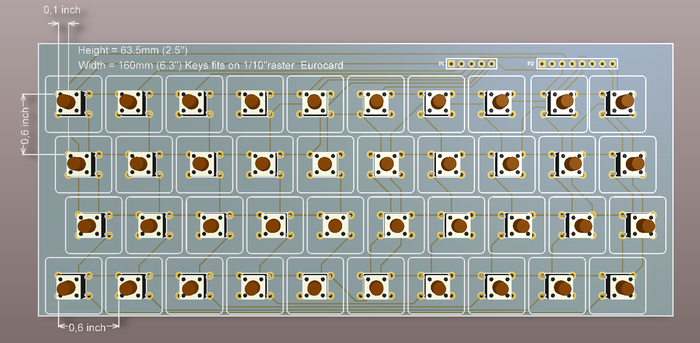

I have also been busy designing a solution for the keyboard. My solution is to use commercially available cheap 6x6mm buttons, which (with some effort by bending the pins a bit) can be mounted on an EuroCard sized piece of 1/10"raster perfboard, the result would like something like the picture on the left.
ZX14 keyboard preview
Here is the schematic of the keyboard: File:KB matrix schematic.pdf
I also designed a new keyboard overlay suitable for such a keyboard with the keys going through holes in the overlay. Here is a drawing showing how it would look:
Here is a .PDF version that should be correctly scaled when printed on A4 paper.
