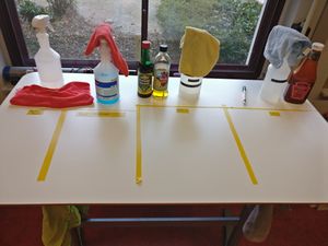

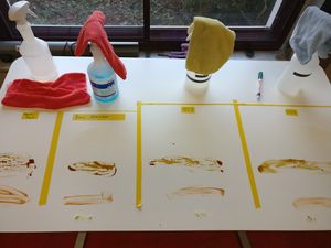

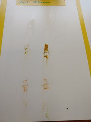

  • Test setup :
    • Compare : Demineralised water, Alklanet, RevKlanet V0.2, RevKlanet V0.3
  • Testing protocol :
  • Apply and dry for 30 minites
    • Wok oil
    • Ketjap Manis
    • Ketchup
    • Meggele garlic butter
  • Attempt cleaning with a clean microfibre cloth and report results
    • Spray area with a single pump (we are using old Alklanet bottles)
    • Wipe 1/3 immediately in a single downward stroke
    • Wait 10 seconds then wipe 2nd 1/3 with a single stroke
    • Then clean the final 1/3 until clean
    • Then clean the entire area with the same product

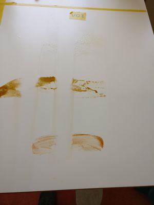

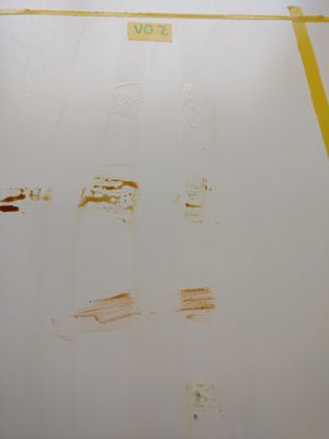

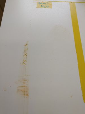

Results V0.2 and v0.3
  • Overall findings : Both V0.2 and V0.3 work as good as Alklanet. V0.3 dries fastest, and degrease markedly better than Alklanet. Probably because we use the a higher concentration of alcohols, and the wetting agent greatly helps as wel.
  • Demiwater :
  • Alklanet :
  • V0.2 :
  • V0.3 :
