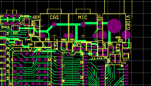

29 DECEMBER 2015
Finalized the revision 2.2 layout, just before year end.
This is how the new revision 2.2 layout looks, note that unlike the previous version I left out copper fills.
An attentive visitor to the ZX81 forum made me aware that the label for the I/O expansion latch port was incorrect, as /OUT_FE, it should have been /OUT_7F, the corrected schematics (Picture and .JPG) have been updated.
30 December 2015
I noticed I could replace one IC (U10, a 74HC1G04) with the unused inverter of U21, I did that and renamed U31 to U10, and also added one more decoupler cap, and I updated the changes in the layout, and did some final optimizing of power traces, and rearranged silk screen texts to horizontal.
I updated the layout picture, and the schematics, as seen above.

June 2020 I received news about errors in the latest gerber files
There seems to be slipped in a wrong file among the gerber files I uploaded in October 2020, it seems the top solder mask layer was a wrong one, and did not belong in the .ZIP file I uploaded to Github. when I downloaded the gerber files myself I could see there was something wrong, especially in the top right hand corner.
These picture shows screenshots of the gerber files I downloaded from GitHub end June, 2020, left the full picture right details showing errors in the soldermasking, so this is the old rev 4,0 version, don't use this to create PCB's!
Because of the corona lockdown, which also affected RevSpace, It took me some time to investigate the problem, also because I needed an old, and previously written off laptop, that has no battery and a French keyboard, but it has the now defunct CAD software with which I designed the ZX81+35.
For the new ZX-81+38 I bought a new Laptop, and switched to KiCAD, and I hoped I would never have to use the old beast again.
But I decided the only way to solve the problem reliably was to get the old laptop back and get it to work again, and create a completely new set of corrected gerber and drill files revision 4,1
So these are pictures of the gerber viewer showing rev 4,1
