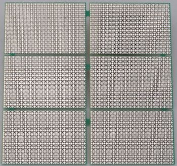

electroniceel's advanced protoboard has 1.27mm pitch pads for SMD components, mixed with standard 2.54mm through-holes.

Most convenient size is probably 5x3cm protoboard - the repo has gerbers already panelized and these fit 6 protoboards per 100mm*100mm panel. There are two alternative designs:
  • protoboard on both sides
  • protoboard on one side, ground plane on the other side
1.2mm thickness is a good compromise for weight.
