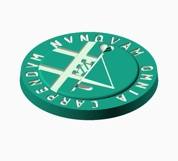

OpenSCAD model
The emblem of the seal is in two halves: one half is a pump drill, drawn half to a centre line. The centre line is denoted with a half-hatched heart, which was the pre-war method of drawing a "heart line". The other half is a mill wheel. The mill wheel is drawn around a wooden axis, which is hatched.
The pump drill is the symbol of the wood- and bone worker in Archeon (my former profession), and the mill wheel is the symbol of the voluntary millers (which I am now). The heart in the line is the love for the technology. Drawing something half against a centre line is what a technical draftsman would do, and that is a one of my former professions also. The motto "NVNQVAM OMNIA CARPENDVM" means "never take everything".
