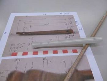

After working out the measurements into a LibreCAD drawing, it was not difficult to make a 3D model in OpenSCAD and print it. This allows me to make a new block and tune the holes. The sound of centuries ago can be heard again!
My aim is to learn the technical difficulties and strategies for making this kind of instrument. Therefore, I want to make it on a pole lathe, and when that succeeds, forge a spoon drill to make the bore of a another one.
