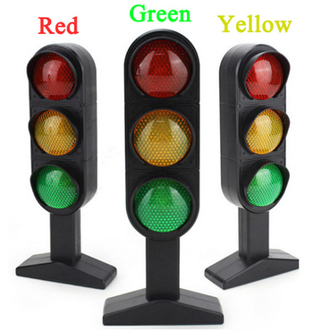

The plan is to use an ESP8266 (e.g. Wemos D1 mini) along with a modified toy traffic light (see below). Perhaps I'll need some kind of LED or bulb driver too.
Apparently, the ESP8266 can source about 12 mA and sink about 20 mA of current. This is enough for a small LED, might need more, I'll just have to see what kind of LED/bulb is inside the toy traffic light.
Bonus point if we can add sound when the status changes.
I'm using This one , to be modified with the ESP8266. It lights the lanterns in order, speaking some Chinese for each lantern. The lanterns are basically white LEDs behind a colored piece of transparent plastic.
