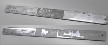

  • 2mm 304 stainless steel plate, 2B finish
  • 2 10x40x2 strips, riveted to the building, with 2x 3mm rvs screws , holing the plate to the building
  • Use Vinyl sticker as resist, also sticker the back and edges
  • Etch for 2 to 3 hours with 40% FeCl3, in a washing machine leak tray
graphic design
  • Logo
  • LED unpolished 2B surface, stained with Copper sulphate, to get a golden color. Will most likely patina to green over time.
  • Letters polished rvs
  • rest etched
