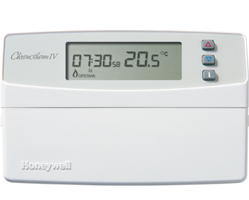

My house has a thermostat in the living room. It controls the central heating bij switching a boiler on and off. Although it is a relatively advanced thermostat (Honeywell Chronotherm IV), that even has some provisions for remote controlling/overriding, and extra temperature sensors, I just have the basic connector-plate that is missing the physical connections for this. And I'm not going to bother hacking them in, as I'm not satisfied with the current set-up for several reasons.

Basic idea
  • Replace the thermostat by a relay/FET capable of handling the 24 V 'interface' to the Boiler. (arelay is enough for basic on-off 24V, FET probably needed if I want to talk Open Therm to it instead). Control this 'switch' with a microcontroller that can take more input into account than the Chronotherm can/does.
  • Initially just have the Chronotherm proxied by the microcontroller via a direct wired connection, then built up from there.
  • An ESP would seem like a useful microcontroller, as it could get its input(s) wirelessly, and a nice step two would be to have one ESP control the boiler, and another connected to the Chronotherm, so it can be easily moved to whatever room I want it to monitor, and have them talk to each other, either directly or via MQTT.
  • Next, move the final decision making away from the Chronotherm, and make it just one of potentially many sensors providing suggestions. Final decision to turn on/off the Heater would be made on the microcontroller controlling the Boiler, but it might be 'strongly influenced' by a more intelligent program running on a homeserver.
