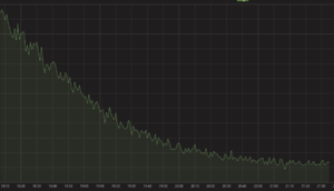

In order to try and get our space geiger to display something more interesting than just random variations of natural background, it was put to use measuring the natural decay of radon progeny floating about in the basement of our SectorV location. A piece of filter paper was draped over the opening of our shopvac, and left to suck up airborne particulates in our server room, which of course happens to be the room with the least amount of ventilation. I let it do its thing for about five minutes or so.
Radon daughters are mostly alpha emitters, so the space geiger was retrofitted with a different tube that is able to detect them. The stock tube (a chinese M4011) does not sport a mica window, but I have a mullard zp1430 that does. After turning off the vacuum cleaner, I promptly walked the filter back to the hackerspace and plonked the tube on top of it, with the mica window pressed right up against the paper surface.
See the graph below for a nice exponential decay curve of the filtered radon progeny. It surprised me how little time it took to collect enough radioactive particles for a decent curve to show itself. To give you an idea, the peak reading represents a particle count that is roughly 25 times above the normal background rate. I've also included a picture that showcases our highly advanced setup.
