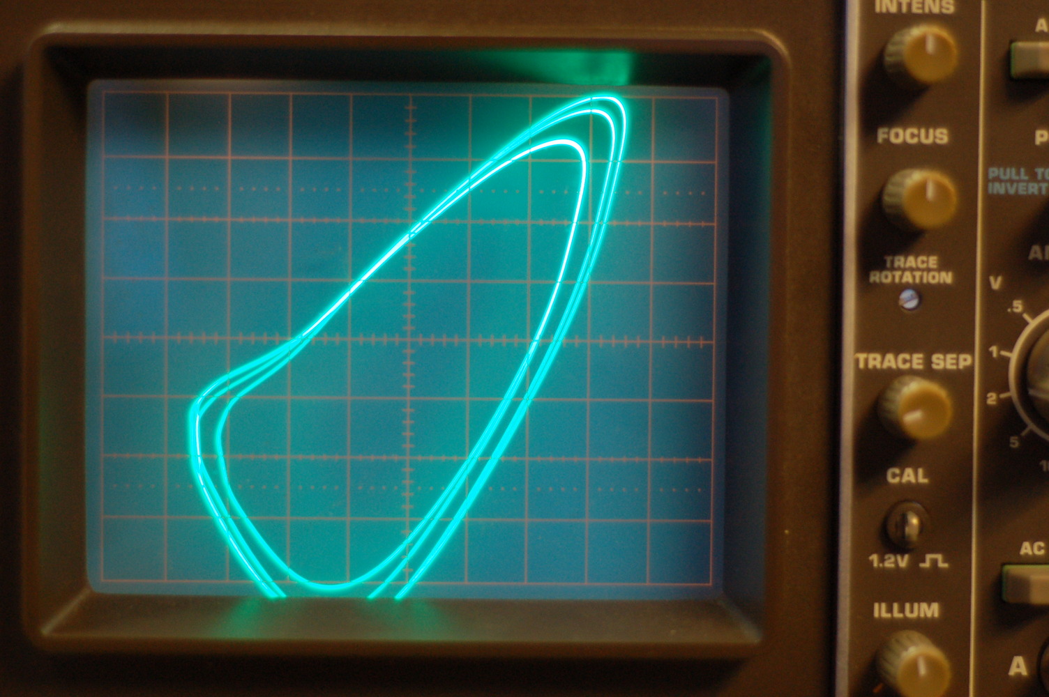

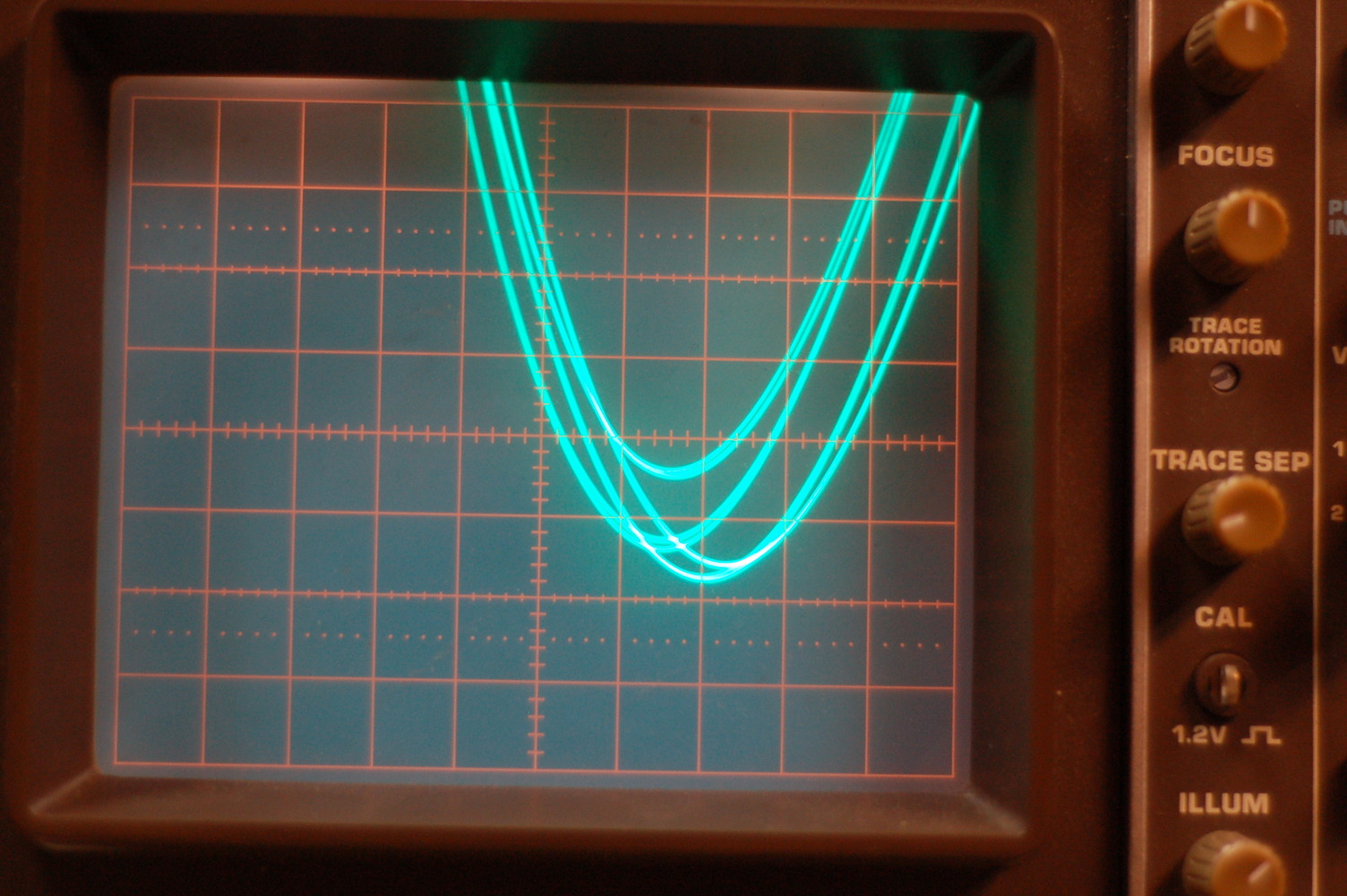

- Following : http://www-physics.ucsd.edu/~des/DSmithChaosExperiment.pdf
- Working oscilloscope and signal generator present, capable of 2Mhz

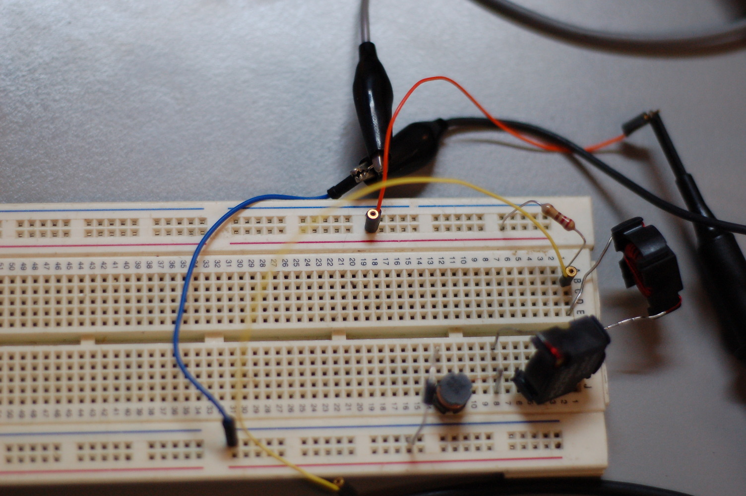

- Components according to the manual :
- 200 ohm resistor
- inductor, 100 microHenry needed, available a PE-53653 , with 16.1�H
- diode - either works: 1N4001, 1N4004, 1N4005, 1N4007
- As built, the circuit does not display any chaotic behavior as we change the amplitude, The inductor is almost 5 times to weak.
- I have several spools, adding an extra spool in series, bringing the inductance up to 32 �H does not help.

- 1N4007 diode
- 220 ohm resistor
- (2 x 16) 32 �H + a random spool (code 471K 98139)
- Signal:
- 1.5 MHz
- Amplitude op 0 dB
- sinus signaal

- With smedings help, we determined that the inductance of the three coils is 1351 uH or approx 1.4 mH
