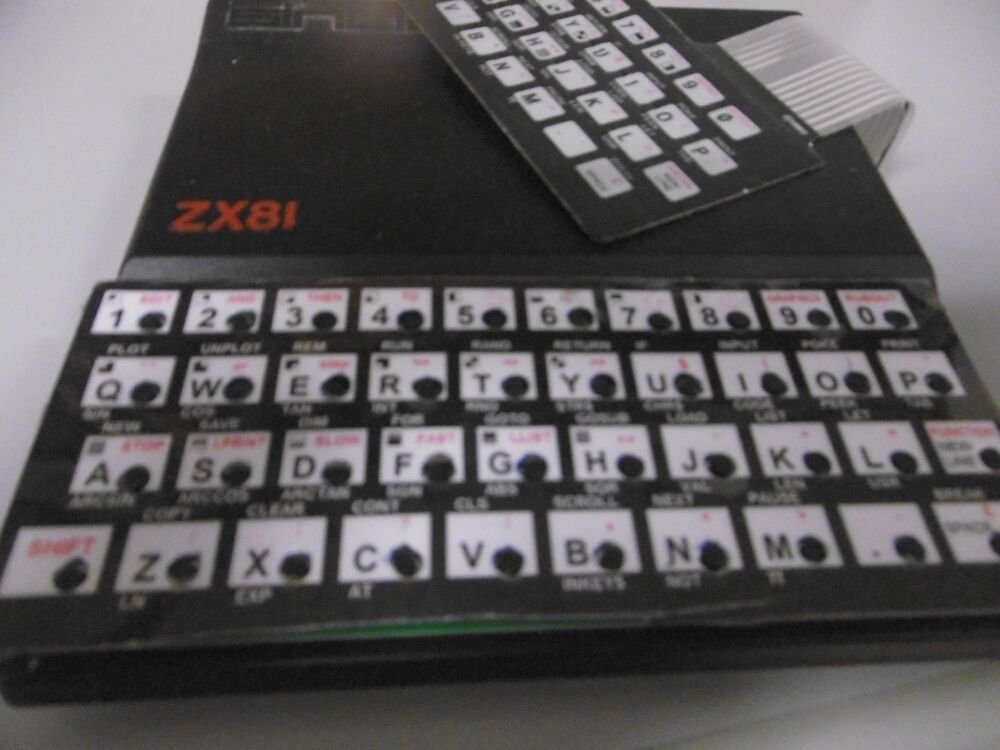

August 23, 2022 Modify prototype keyboard to fit on top of ZX-81
also I'm busy with modifying my old prototype keyboard for my ZX81+35 so that it works as a replacement keyboard for the foil keyboard of a real ZX-81
The size of the keyboard is almost exactly right, only I have added reset buttons, and two LED, and the edge connector sticks out a lot. see:
so I will remove these parts and wire two flat cables directly to the keyboard PCB. After removing the connector, I tried and found that I need two more stripboard rows.
So I removed the wires and removed two rows of strips, leaving one row of holes over, just enough.
afterwards, you can see the remaining matrix wires on the back:
I wired the rainbow colored data and address cables to the board, on the back of the board the signal wires must still be connected to the correct rows and column matrix wires, with the same color wires.
As you can see the keyboard PCB now fits on the ZX-81, and the cables will fit through the slit in the case.
next job will be to wire the matrix connections to the 5 and 8-wire cables.

This PCB is a single sided PCB, with only copper on the top side. The 40 pushbuttons are inserted on topside and also soldered to the pads on topside. the flat cable is inserted from the bottom, and soldered on the top. cut the pins on the bottom side off as close as possible to the PCB, and mount the PCB in the indentation with dual sided (carpet mounting) tape, but don't place tape over the flat cable connections. If the flat cable is thicker than the carpet tape, you might need to carve out some plastic to make place for the flat cable.
print out the keyboard overlay drawing, laminate it and punch out round holes through with the keyboard stems will go with a paper punch and a hammer while placing the laminated paper on flat wood. The holes should fit exactly over the buttons stems.
Tuesday August 31, 2022 keyboard works!
Still I had expected the need to twist the data cable, but for some reason that isn't necessary, which means that because I'm using the rev 1.6 board that I expected that the order of the datacable should be wrong! At home I have a real keyboard, so I can finally check what the true order should be. Maybe this means the keyboard PCB is wrong! But I will go to the bottom of it!
here is proof that the keyboard now works!
you can see that I didn't twist the cable.

22, march 2023 picture of my keyboard solution
