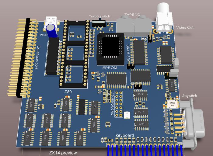

The ZX14 is a much improved Sinclair ZX81 clone built with the modern materials techniques and components of 2014.
it will be fully open sourced effort (but note that the original design of the zx81 is still owned by Amstrad)
3D Preview
Here is a (3D rendered) preview.
