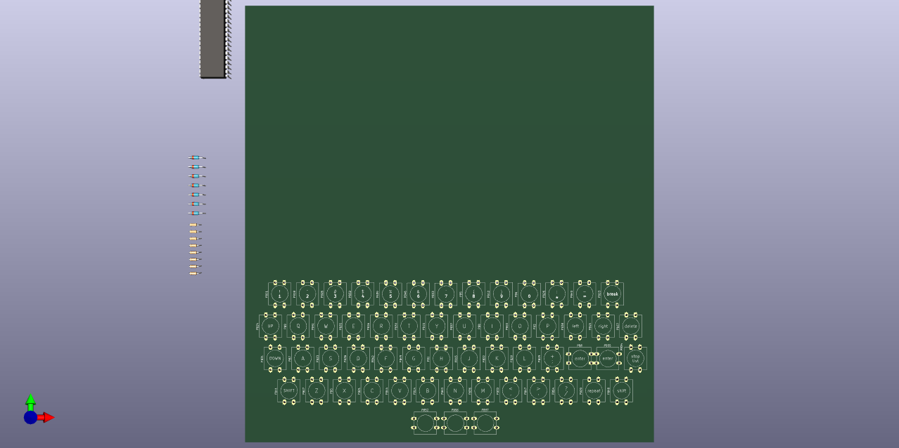

I also imported the parts into the KiCAD PCB layout editor, and figured out a correct key placement, which was one hell of a puzzle, but I think I did it without making mistakes, as the enter key is twice as wide as the other keys, I used a second key for the right half, for the spacebar I made a compromise and used three keys, same as the rhococo. So I added new switches in the schematic, and added four new keys to the layout. I captured a picture from KiCad's 3D preview function, as the keys do not (yet) have a 3D shape, you will only see the keyplacemens as the unpopulated PCB would look. | I also imported the parts into the KiCAD PCB layout editor, and figured out a correct key placement, which was one hell of a puzzle, but I think I did it without making mistakes, as the enter key is twice as wide as the other keys, I used a second key for the right half, for the spacebar I made a compromise and used three keys, same as the rhococo. So I added new switches in the schematic, and added four new keys to the layout. I captured a picture from KiCad's 3D preview function, as the keys do not (yet) have a 3D shape, you will only see the keyplacemens as the unpopulated PCB would look. | ||
I also figured out that the board outline would be 8.85 inch wide or about 22.5 cm. | I also figured out that the board outline would be 8.85 inch wide or about 22.5 cm. | ||
here is a . | here is a .PDF preview, the height (depth) of the PCB is a rough estimate. | ||
[[File:PanGalaksija 3D keyboard preview.png]] | [[File:PanGalaksija 3D keyboard preview.png]] | ||

I also imported the parts into the KiCAD PCB layout editor, and figured out a correct key placement, which was one hell of a puzzle, but I think I did it without making mistakes, as the enter key is twice as wide as the other keys, I used a second key for the right half, for the spacebar I made a compromise and used three keys, same as the rhococo. So I added new switches in the schematic, and added four new keys to the layout. I captured a picture from KiCad's 3D preview function, as the keys do not (yet) have a 3D shape, you will only see the keyplacemens as the unpopulated PCB would look. I also figured out that the board outline would be 8.85 inch wide or about 22.5 cm. here is a .PDF preview, the height (depth) of the PCB is a rough estimate.
