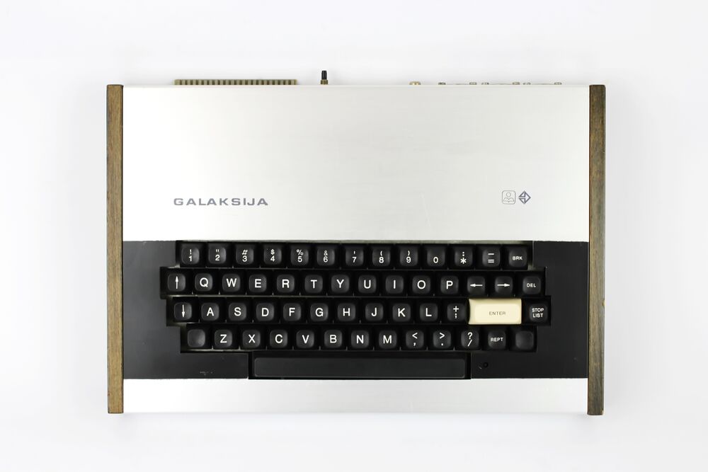

February 14, Galaksija Keyboard schematic
I found a clear picture of the keyboard matrix of the Galaksija.
and a typical keyboard layout
