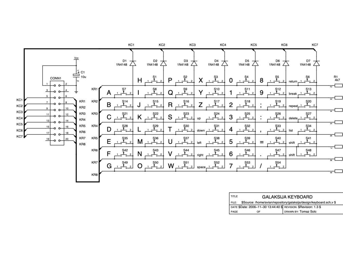

I found a clear picture of the keyboard matrix of the Galaksija. | I found a clear picture of the keyboard matrix of the Galaksija. | ||
[[File:Galakija Keyboard schematic.png]] | [[File:Galakija Keyboard schematic.png|1200px]] | ||

February 14, Galaksija Keyboard schematic
