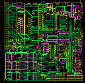

29 DECEMBER 2015
Finalized the revision 2.2 layout, just before year end.
This is how the new revision 2.2 layout looks, note that unlike the previous version I left out copper fills.

June 2020 I received news about the latest gerber files
There seems to be slipped in a wrong file among the gerber files I uploaded in October 2020, it seems the top solder mask layer was a wrong one, and did not belong in the .ZIP file I uploaded to Github. when I downloaded the gerber files myself I could see there was something wrong, especially in the top right hand corner.
This picture shows a screenshot of the gerber files I downloaded from GitHub end June, 2020
