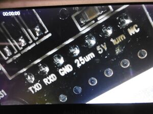

The board

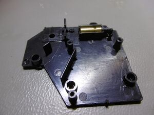

Part optical chambre
To do:
  1. Determine the GPO and GPI of the STM32 while processing
  2. Measure the control circuit of the laser module.
  3. Create a matching circuit, filtering and gain of the instrumentation amplifier analyzed.
The sensor
To do:
  1. Determine type of the photosensor.
  2. Measure size of size of hole under the detection area.
  3. Create a layout of the lightbox. Angles of second order reflections drawn.
  4. Measure the speed of the airflow.
  5. Estimate the focus area of laser beam on the airflow.

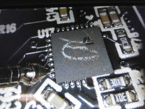

Re-flashing the STM32
Pins cut off
A complication for re-programming the STM32 is that the programming pins (SWD) are cut off in the manufacturing process, see photo. We discerned three possible scenario's for re-flashing the firmware.
  1. Reconnecting the copper ends of the cut-off SWD pins
  2. Flashing via the UART, with help from the BootP pin.
  3. Replace the microcontroller on the pcb with a new one, and put an opensource bootloader on it.
Develop "bare-metal" drivers
Connections
Create bare-metal drivers for:
  1. Blink a led, visual debugging
  2. Laser control, PWM
  3. ADC
  4. UART
The drivers can be tested with short burst of raw measurements, to be output over UART. The developing of the drivers using a easy to use tool chain needs to be established.
