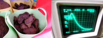

Some experiments with our bog ore
We have about 260 kilograms of bog iron ore at our disposal. The material is quite porous, so a significant percentage of that weight is just unbound water, and even light oven-baking at 150 degrees C for a few hours resulted in about 10% weight reduction. The material seems to be made up of harder silicate concretions in a matrix of loosely bound hydrated iron oxide. After baking, a few good whacks with a hammer is all that is needed to separate the rock into finely powdered ochre dust (interspersed with some fine silt/sand) and harder pebbles of what looks to be predominately silicate-based rock. The majority of the ore does seem to be made up of iron compounds, which is good news for us.
A rudimentary assay of the ore would be useful, so an attempt was made to convert all iron compounds to soluble form with nitric acid. The iron nitrate can then be separated from the unreactive silicates, and the oxidizing nature of HNO3 will handily also convert any Fe(ii,iii) compounds to Fe(iii). This approach hasn't worked so far though, probably because we haven't been able to get the material fine enough for the acid to react with the ore to completion. A ball mill is not yet a part of our toy collection at revspace, but more manual violence and grinding may yield success in a future attempt. Efforts to dissolve the rock thus far have at least offered a little more insight into the chemical composition of the ore. Most of the bulk does indeed seem to be hydrated iron (iii) oxide (goethite), and applying a magnet to the crushed material also reveals what appears to be a small amount of magnetite. Addition of crushed ore to concentrated acid results in some minor bubbling of what is most likely carbon dioxide, pointing to the presence of a small amount of carbonate.
