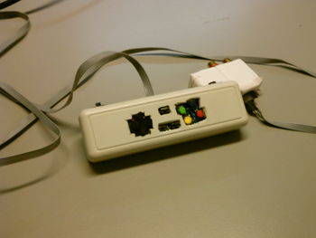

February 14, 2017 prototype finished
Here is a picture of the finished prototype gamepad, which is actually the whole NES emulator, consisting of a Raspberry PI Zero with a support PCB for buttons and some analogue filters for audio. Power input, and AV output is connected through a 5-wire cable to the "NES console", which houses the USB-B 5V 200mA power input connector, and two RCA connectors one for audio, and one for PAL video.
the gamepad which houses the emulator
the "micro NES" is extremely small
To the right is the prototype "micro NES", at the end of the cable, which is extremely small, as it (almost) only consists of the power and A/V connectors.
These pictures show the prototype, the final version will have a PCB for the various A/V/power connectors (an USB-B connector for power, and three RCA connectors, one for video, and two for stereo audio) in the "back", and a single RJ-12 (6P6C) modular jack connector on the front, so you can (dis)connect the gamepad to the "NES", with six wire modular cable. The sixth wire means I can also add stereo capability. I will make 4-wire cable capability optional, when you add a wire link to the PCB to combine power and signal GND, and restrict to mono audio, but this is not recommended.
