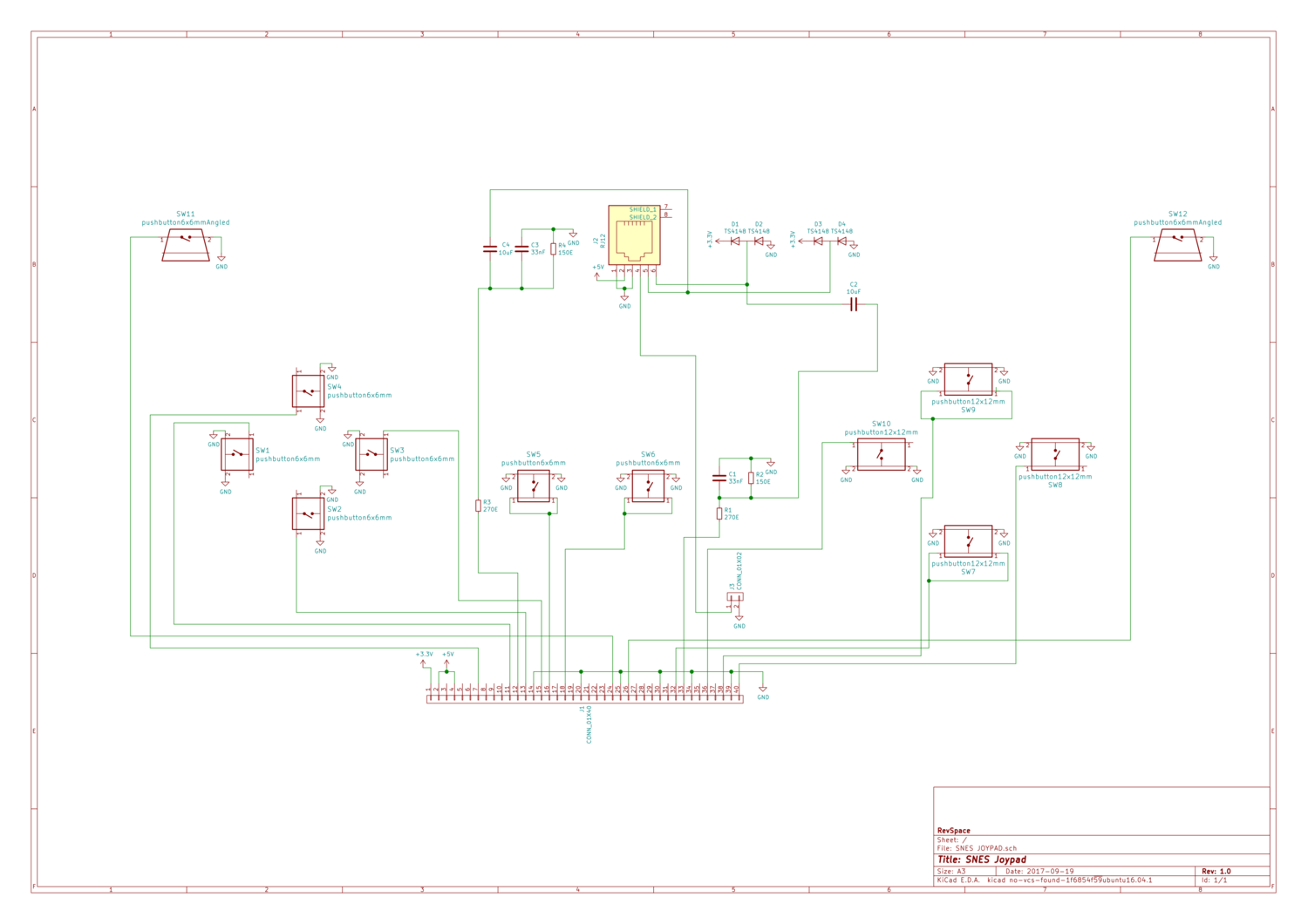

This is the final schematic:

October 11, 2017 Redrawn the Schematic with KiCAD
This is the new schematic, drawn in KiCAD. File:SNES JOYPAD.pdf I also started on component placement. Note that this schematic reflects the actual placement of all the components, also this version uses 12x12mm buttons for A B and X Y buttons, which support colored key-caps.
