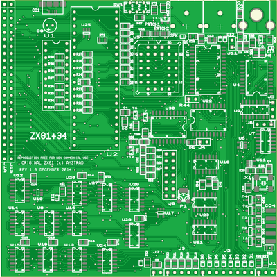

Even though I was hospitalized, then immobilized for several months (in the months of June July and August 2014) due to an operation on my leg, I still managed to work a bit on the layout of the ZX14. And on November 25, 2014 The layout work reached 100% connectivity. Here is a preview of how the work was progressing then. Clean-up, optimizing and copper filling followed somewhat later. The picture below was actually a screen shot from a gerber viewer of how the board looked in September 16, 2014.
[[File:Component placement 16 September 2014.png|500px|thumb]]
Some weeks later the cleanup was ready, and this is a picture of how the PCB will more or less look like, when it is finished. Note the old PCB layout still has the, nor abandoned name "ZX81+34".
[[File:Component placement 16 September 2014.png|500px|thumb|left]][[File:ZX81+34.png|400px|thumb|left]]
It will be beginning of 2015 before I will start building and testing prototypes. I have also re-reconsidered the name, and instead of ZX14+34, as previous it will now be called the ZX15, which is also what will be printed on the PCB, so the silkscreen will be change.
Reason being that zx81+34 is simply too silly a name, it was only chosen because of kawasaki ZX-15 motors, (which have computers inside) and because I wanted a link with the ZX81 in the name.
[[File:ZX81+34.png|500px|thumb|left]]
