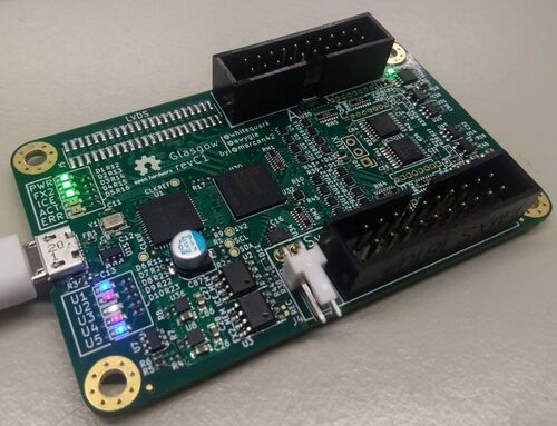

As of 18th Feb 2020, the first board works, but pin A7 is flaky. Replaced the level shifter on Feb 20: now everything seems to work! Look at the pretty lights:

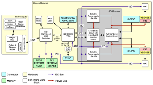

Glasgow is described as an `open source multitool for digital electronics'; it's basically an FPGA with configurable level shifting for 16 ESD-protected I/O pins, so you can connect it to a whole bunch of random interfaces:

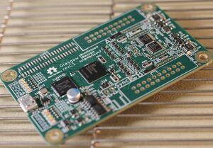

noopwafel tried making one in the reflow oven (14th Feb 2020). Next time need to check reflow temp profile, placement in oven, placement of components, how to apply solder paste, need better tweezers, and there are other lessons along those lines. Having said that, it looks OK:
