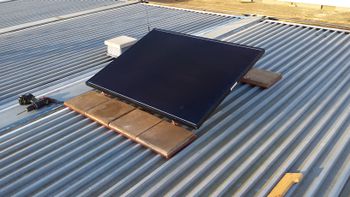

There is a solar panel placed on top of the new sparkshack. Datasheet
Be careful not to touch bare wires, ever! This thing can kill you, not easily, but it can! And it hurts like hell.
Benadski is building a converter to charge a 42V 10Ah battery pack. Use of this 42V power is free until depleted.
Specs:
Orientation: SW, 20 degrees tilted.
Power: 165Wp (or slightly less/more)
Open voltage (max): 110V DC
Shorted current (max): 2.2A
At nominal power: U: 85.5V I:1.93A
