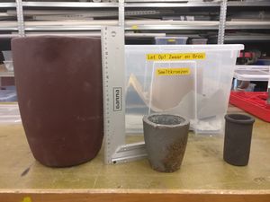

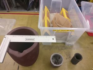

Our crucibles
  • several small graphite ones <50ml
  • ~100ml graphite
  • 200 ml SiC graphite
  • 2 x 400ml graphite
  • 5.3 L Sic
The seller of 5L crucible claims "Ze zijn geschikt voor het smelten van metaal tot 1100°C". Silicium Carbide ( SiC) crucibles all over the internet are all rated up to 1500-1600 °C. No reason to believe that ours is any different. As the seller is a art supply store, I suspect this is a non-techie way of saying "Use only for non-ferrous metals", which is consistent advice for all for SiC crucibles. If you are serious about melting cast iron or steel, you probably know what you are doing anyway ;)
