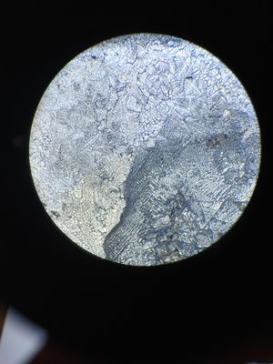

10X magnification of one aluminium casting that was poured. Attempt no landings here.
  • Used steel wool as soruce of Fe, hoping for fast dissolving in Al. Does not work well.
    • Too large volume, makes packing into crucible difficult
    • Starts burning after while being added to liquid Al
    • Tried wrapping in alu foil, in tight packets. Sort of ok, but very, slow to dissolve, borax get in everywhere , mess.
    • Next time either skip Fe, or try shavings from a file of drilling swarf.
    • With filings, iron will still take a long time to dissolve in Al
