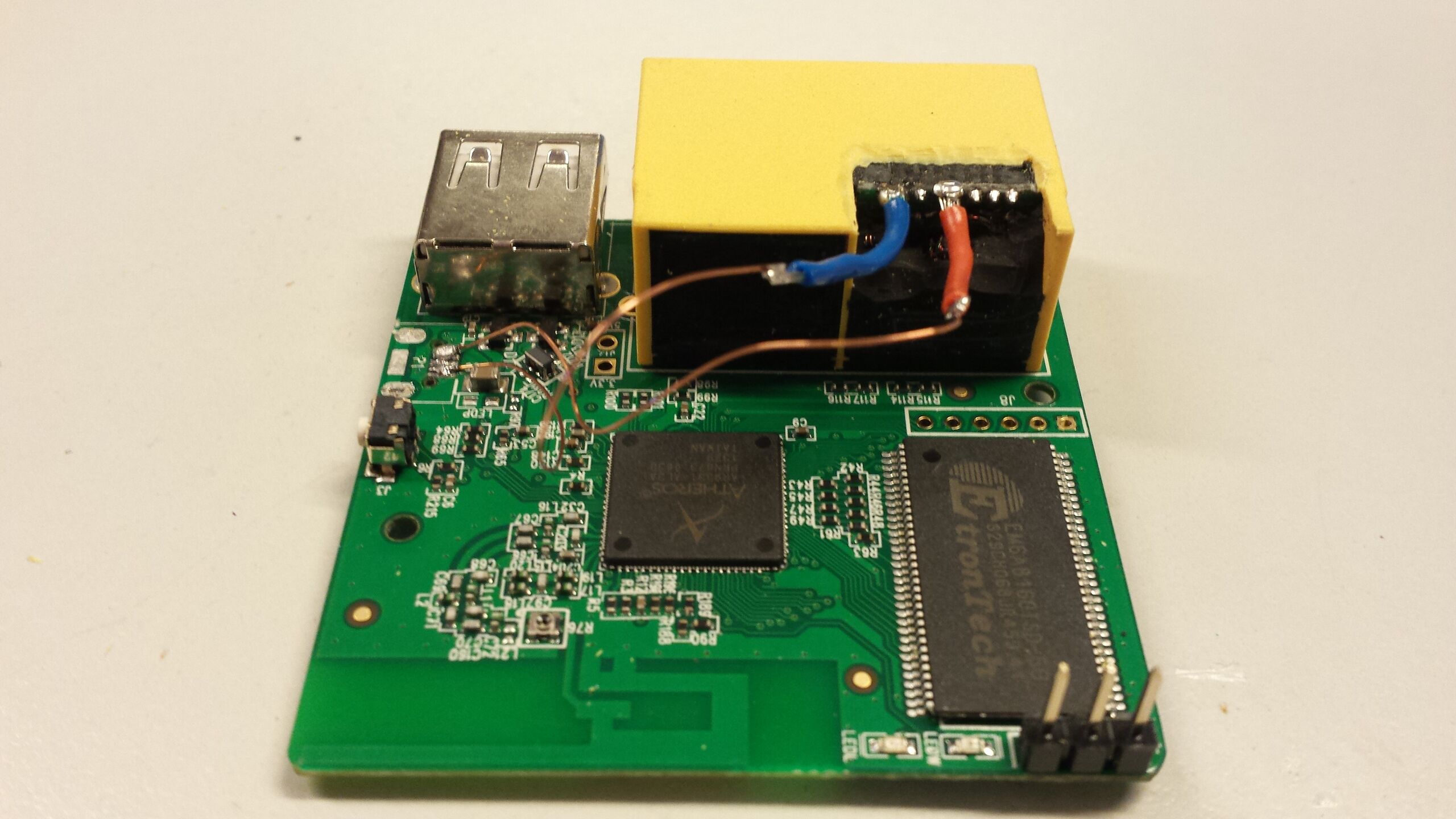

Wires hooked up directly, pins 3, 6, 7 and 8 are not routed on the pcb as noted in the datasheet. A DC-DC converter should be added.
