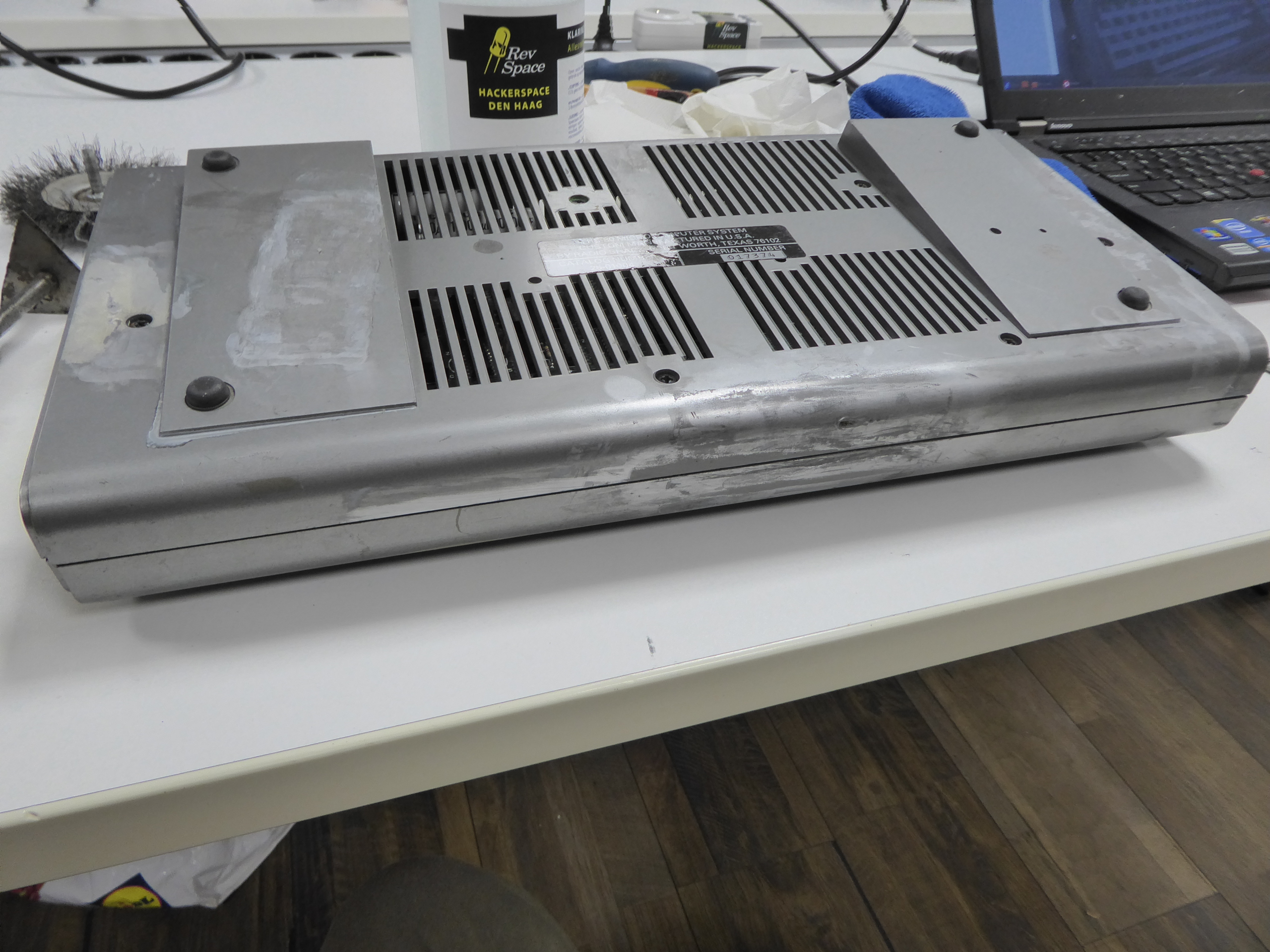

bottom after sticker removal:
top after sticker removal:
as can be seen the case needs a re-paint.
