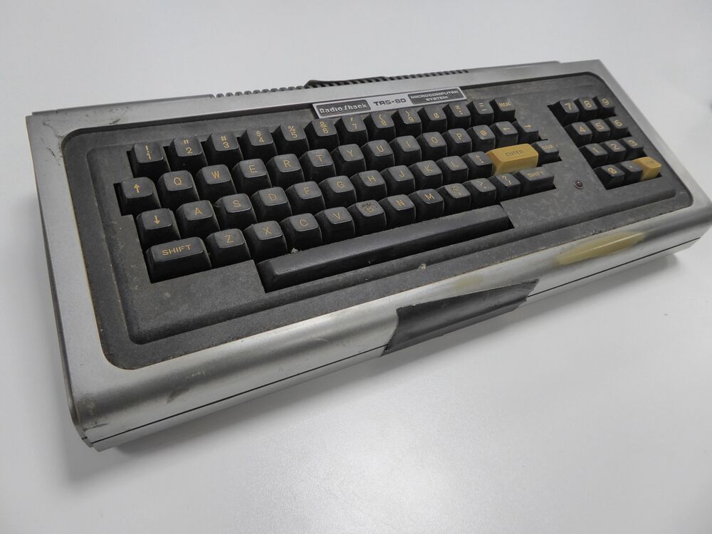

The NaVGM (National Video Game Museum) in Zoetermeer the Netherlands has a separate room for home computers, and in there you can see (at the moment in August 2024) two of the trinity of computers, namely a PET (Personal Electronic Transactor) model CBM 8032 (this is a later european "business model" with a 80 column screen and 32K RAM, I hope to replace it with a 40 column model that is much better supported with video games, I am the owner of these two PET's) we also have an Apple ][ in a showcase. but we did not have a TRS-80 computer,until now that is. Unfortunately the TRS-80 model 1 we got has earned the name "trash-80". It looked like it has been in a trashcan for at least 30 yes.

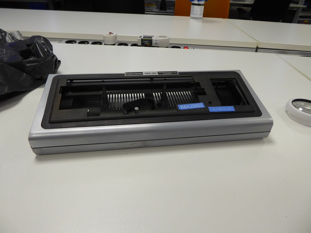

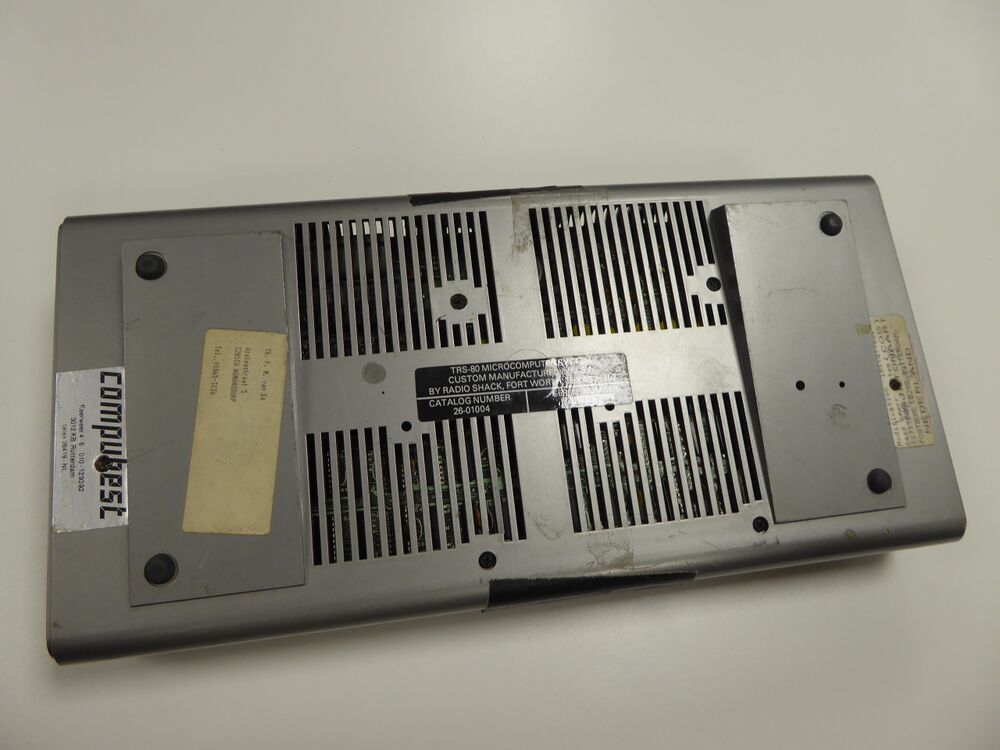

the filthy model 1: the museum received:
Top:
bottom:
bottom after sticker removal:
top after sticker removal:
as can be seen the case needs a re-paint.

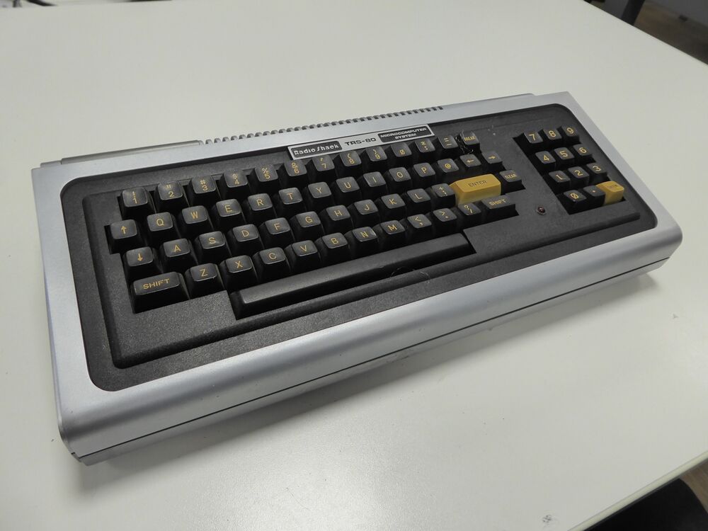

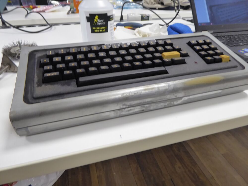

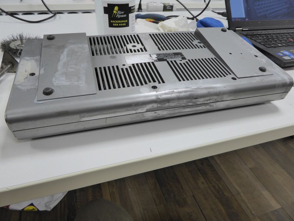

After re-painting the Case
I re-painted the case, after removing all the stickers and degreasing the case with isopropanol.
I started a applying a grey primer, then after the primer had dried I applied acoating of silver spraypaint, and the result was excellent IMHO.
here you can see the front, not the white spot where the silver paint was completely rubbed off is completely gone. Note the blue stickers that mark that this is a project of mine, and since when it is stored in storage.
seen from the back you can see that the broken off "rib" is repaired and you can barely notice that it was ever broken off.

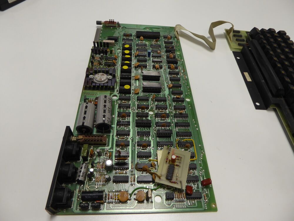

The mother board
looking at the TRS-80 Motherboard you can see that it was extensively repaired and modified. The mother board is mounted inside the case with the components hanging down on the board, so that the keyboard can rest on the bottom of the PCB with some wide round rubber standoffs. One modification that is immediately obvious is that that the short FLEX-PCB connection between the Motherboard amd the keyboard PCB. A known weakness in the design of the TRS-80 is a broken connection cable between the main and keyboard PCB. The previous owner aware of this problem has decided to take drastic actions, and replaced the short and breakabl cable with a much longer and more supple flexcable.

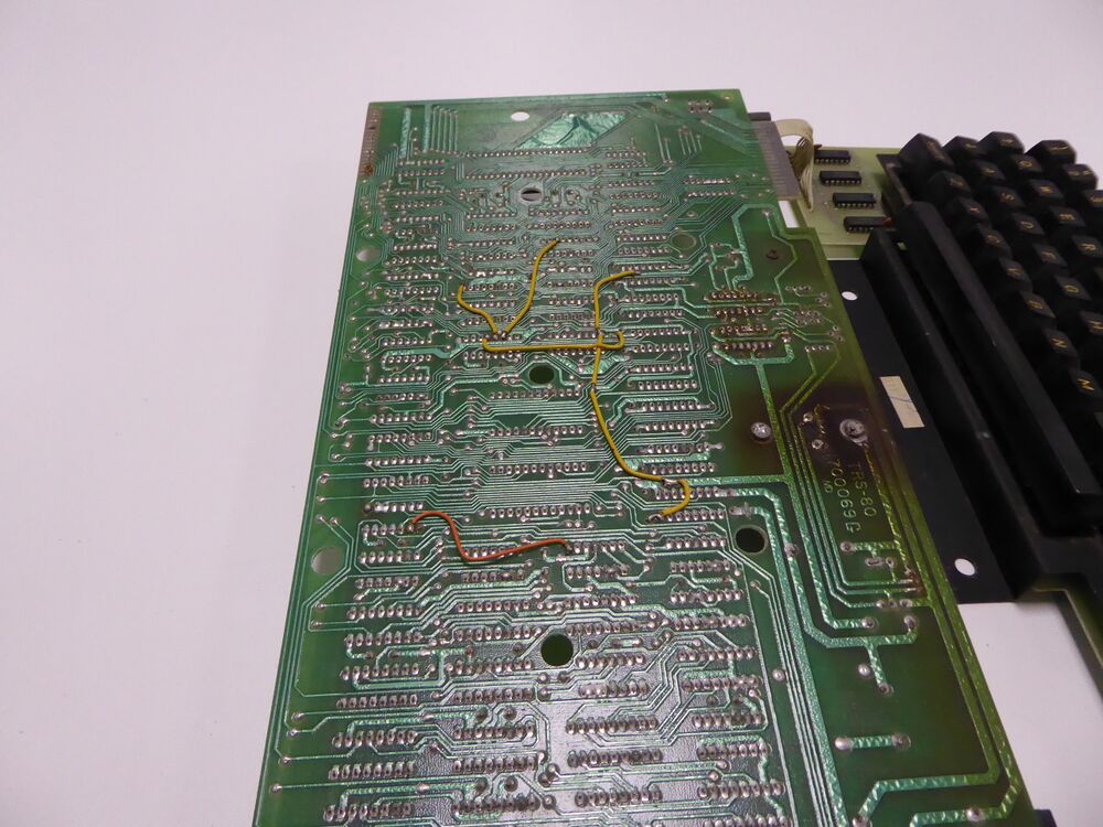

A normal TRS-80 main mother board contains 16K DRAM, and needs and "expansion interface" to add another two banks of 16K DRAM chips for the 48K RAM that BASIC 2 expects. the previous user probably did not want to buy the very expensive expansion interface and knew that it was possible to replace the uPD4116 16K x 1-bit with uPD4164 64K x 1-bit chips. I knew that this could be done because I have modified dozens of TRS-80 model 1 computers myself in the early 80's. because the uPD4116's use thre different voltages, and the more modern uPD4164's use only +5V, you have to remove some decoupling caps, and wiring .
You can see the patch wiring for this patch from the solder-side of the PCB:
One other problem many people opted to address is that the model-1 did not support lowercase letters, the designers chose a spare a few dimes by only using seven M2102 1K x 1-bit static RAM chips for video RAM. So a patch to install the missing RAM chip was quite common, and this user seems to have done the same thing. the small rectangular PCB seems to indicate this is the case.
I have not powered up the computer yet, I want to be careful, and examine the schematics first. I noticed the main +5 TO-03 Voltage regulator seems to have overheated. And I want to be sure the main regulator the MC1723 is still okay.

One of the 1977 Trinity, the TRS-80 model I
