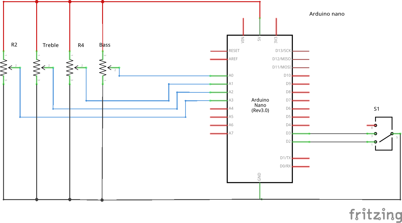

Stripped the main board of all transistors and other electronic components except the switches and potentiometers.
One tri-state switch has been connected, I will use two GPIO pins to detect in which state the switch (up, middle, down) is to save GPIO pins.
