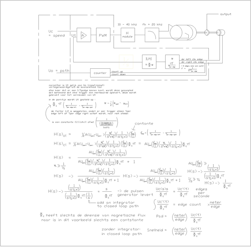

connection diagram:
blokdiagram sturing plasmasnijder
(slush)
