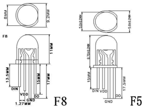

The lamp is controlled by an ESP8266, a Wemos D1 mini board.
The LED is an RGB LED with built-in PL9823 controller.
The PL9823 is compatible with the WS2812B RGB LED as far as I can tell (the WS2812B driver in the FastLED library works with the PL9823).
Connections (using dupont female-female):
The LED can be one of these LED shields:
* LED Din to Wemos D1 mini pin D2
* 1-LED shield: https://wiki.wemos.cc/products:d1_mini_shields:ws2812b_rgb_shield
* LED Gnd to Wemos D1 mini pin GND
* 7-LED shield: https://wiki.wemos.cc/products:d1_mini_shields:rgb_led_shield
* LED Vdd to Wemos D1 mini pin 5V
This is the same pinout as used by the [https://wiki.wemos.cc/products:d1_mini_shields:ws2812b_rgb_shield Wemos WS2812B RGB shield]
The 7-LED shield is a lot brighter than the 1-LED shield.
