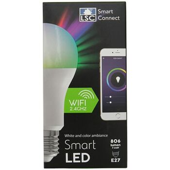

Intro
This page is about a WiFi enabled LED lamp from the Action store, with E27 form factor. The associated Android app refers to this lamp as A60 RGB-CCT.
I hoped this would be an ESP8266 based lamp, so it can possibly be flashed with my StofAnanas/stoflama firmware so it can indicate local air quality (PM10).
More info:
Still it might be nice if I can add an output option to send the particulate matter RGB value to a bulb like this, using the UDP protocol.
Hardware info
The lamp communicates over 2.4 GHz WiFi.
Inside is a SM2135 LED controller.
It has two setup modes, triggered by switching it off-and-on three times quickly in a row
  • fast blink mode: about 1 blink per second
  • slow blink mode: about 1 blink per 3 seconds
The manufacturer part of the MAC address (68:57:2d:1a:6a:ea) points to "HANGZHOU AIXIANGJI TECHNOLOGY CO., LTD", see https://www.cleancss.com/mac-lookup/68-57-2D
It received ip address 192.168.1.240 through DHCP from an OpenWRT router.

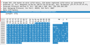

broadcast
The broadcast message is 164 bytes, starts with 0000 55aa, and ends with 0000 aa55.
Capture
broadcast message
