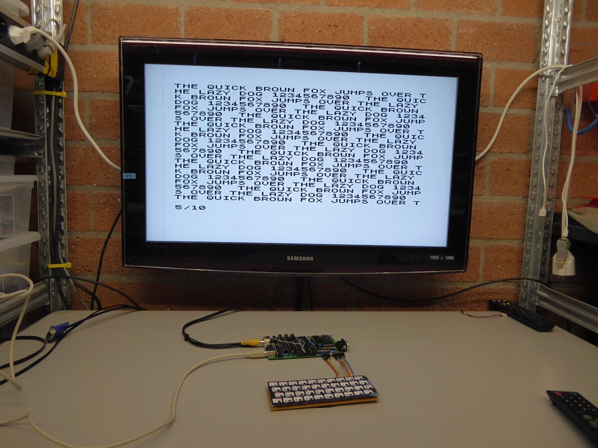

This project is completed, but the whole story about its design can be read here: https://revspace.nl/ZX81plus38_simple_to_build_ZX-81_clone
here you can see it working:

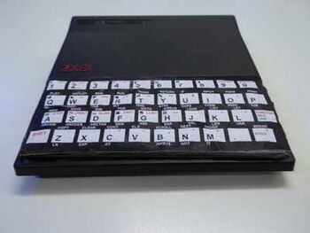

You can get all the files to produce a ZX-81 clone here from my gitHub page: https://github.com/mahjongg2/ZX81plus38 (revision 1.9 is the latest version (in march 2023). there are files to produce the PCB's (both main PCB and a keyboard PCB that fits inside the plastic), as a replacement for the keyboard foil, but this keyboard has real mechanical buttons, you can use a plastified keyboard overlay and can choose to have short keys just under the paper, or you can punch holes in the overlay and use buttons with longer plunger that stick through the keys. This won't effect the legibility as all texts are organised around the punched holes.
