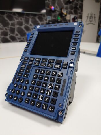

The Winwing CDU series is a range of affordable flight simulator peripherials based on flight management computer interfaces in modern(ish) airliners. The MCDU is based on a Thales MCDU used in Airbus aircraft (A320 family), while the PFN 3N is based on a Smiths Industries unit used in Boeing 737NGs.
That translates to a small but readable display, which can display 336 characters over 14 lines (24 chars each), a full alphanumeric keyboard with a smattering of special characters, some page selection buttons which are not relevant to the project, and 6 Line Select keys on each side of the display, which are used normally to interact with options displayed on screen.
The device connects to a PC over a USB-C cable, and presents as USB HID device, by default a game controller on Windows.

Just after I came back from my holiday, the 737 version of the CDU arrived. Between the EXEC light and button, Menu, Prev Page and Next Page buttons, I think this one is a bit more suited to the task, actually. While printing the stand, I've used the MCDU to explore the other thing I've found - a multiplatform controller meant for Linux/Mac for use with X-Plane. The controller is based on Python, and I was easily able to extend it to work on Windows.
I decided to move forward with this implementation, skipping the Windows driver, as I expect to eventually drive the CDU from a RasPi and not from a Windows PC. A Python based solution will be easier to port, and if I write it from start as a thin client (still unsure if it should be, or should it have some independent functionality) it should be easy to test by just running it locally and pretending to be the flight simulator for starters.
The problem with that is that while the driver works well with the Airbus MCDU, it does nothing with the 737 CDU. There are some differences in the protocol I need to find.

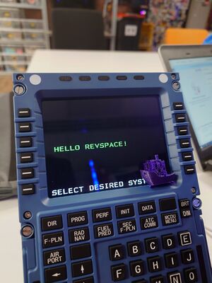

May 15th, 2025
CDU showing Hello REVSPACE! text with a laptop screen showing in-development version of Windows Controller
In development version of HomeCDU Controller, first step done
I've carried on with the software now, the initial version only generates a payload (simple green text of normal size) that I can copy to Postmaster, now I need to decide if I will bother implementing WebSocket or go straight for the driver. I've added a link to GitHub repo where I will be maintaining this software to the bottom of the page.
May 14th, 2025
CDU with a Hello World type message, and a benchy I was experimenting with
I have received the MCDU on May 13th, and started messing with it the next day.
What I have initially found, is that MobiFlight, an open-source platform for hardware controls integration with flight simulation software, already has support for Winwing CDU in beta. Unfortunately, while the platform itself is open-source, it seems that it is using a closed-source driver to drive the device (hence the goals to first integrate the existing closed driver and then replace it). At least figuring out how to interface with the driver will be easy.
For starters, I have used Postman to make a connection to websocket interface that MobiFlight is exposing to outside world to drive the display.
Unfortunately the format used for this is... not great. A JSON array of 336 arrays, each of them corresponding to a single character, each character being either empty, or having 3 elements - character to be displayed, color, size (small or large). Hence, the need to have something more user-friendly to generate payloads for testing.
