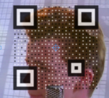

Make it work with a full-color moving video in the back.
  • Use same large markers
  • Make them a little more transparent (25%)
  • With contrast of the large markers, reader will construct lines along which the blocks are sample
  • Reduce size of blocks to about 1/9th of original blocksize
  • Make everything around the block transparent
  • Result: working transparent QR code!
Does not work on all readers, zbarimg fails on the PNG, but could be due to PNG alpha channel interpreted in the wrong way.

Sample image
Below transparent, PNG32 format file can be overlayed on any graphic and redirects to http://revspace.nl/
