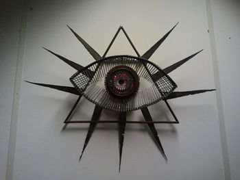

The eye of the Internet makes one aware that Internet not only knows everything, but is also sees everything, courtesy of the many Webcams at the space.
The eye communicates with you by changing its color. When nobody is watching, it is green. When someone (or something) starts watching webcam 1, the eye turns to blue, then yellow, orange and red. When more than 5 streams are active, the eye turns white.
Steel structure
Components so far :
- A gear
- A thin slice from a electromotor stator
- A lot of large nails
- Pieces of rebar
- slices of steel plate
Build process
The finished product, looking at you
Hanging in the lunge of Revspace 2.0
Front of the board.
Back of the electronics board
Eye with the rays, mounting bracket, ready to mount the electronics.
Getting a sense of how the color works with the steel, testing the led cables.
Breadboard of the working prototype. We later connected all the leds behind single resistors per color channel.
Cleaned, and mounted in a triangle. Triangle cost a surprising amount of effort, especially starting from bent junk rebar.
The uncleaned result.
The welding process.
The final study before welding.
The back of the iris. I should have grinded the zinc coating first. It became really messy and required a lot of electrodes.
The completed iris.
After welding bunch of nails to each other, and burning them in the process, a I decided that I really needed a frame to carry the eye edge.
Second study
Initial study
