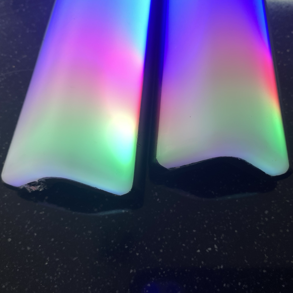

We bought two IKEA SKAFTSARV's and inserted ESP32C3 mini boards in, placing the board in the second one such that it could be accessed from one end.
End view of two IKEA SKAFTSARV lights showing rainbow lights, one of them with a cutout in the end to allow access to the USB-C port of an ESP32C3 board.
The first one has the controller board inside, making it inaccessible to reprogram without disassembling the light again.

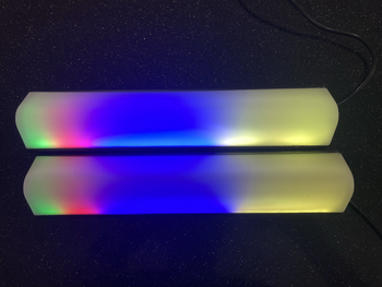

Python & WLED
We flashed the first light with WLED and one of my children wrote a python script to drive the WLED app using data from Bertrik's server (in JSON format). We now have this running every fifteen minutes on another computer at home to force and update.
C++ and JSON parsing
Separately I've written c++ code which runs in the controller board on the second light (where the board's USB-C port is accessible for reprogramming). This connects to Bertrik's server and grabs the JSON and presents it. In this this is essentially a reimplementation of the original Power Light project, but in a strip.
