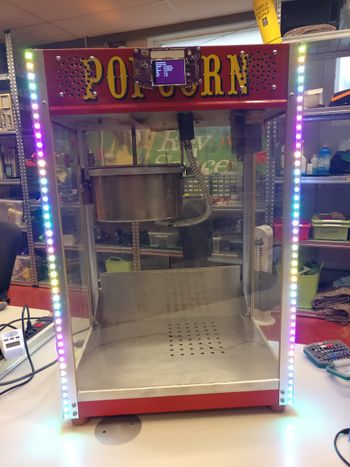

- A second hand Paragon Theater Pop 8 machine. It even comes with a full technical manual.
- TiLDA Mkπ board, acquired during the wonderful EMF 2016 camp
- Set of 10W speakers, salvaged from an old Phillips TV
- YX5300 UART MP3 player, clone of a Catalex serial MP3 player.
- 5W stereo amplifier
- Meanwell 100W 5V power supply Slight overkill, we need about 60W for the NeoPixels full on and full volume music, but it is good to get extra power, as the power output drops as things get hot above the kettle.
- 5m NeoPixel RGB strip
- 2 turbine-style server fans, out of an old SunSfire x2200
- Random thermally stable wires, protoboard and some extra caps for buffering the 5V and filtering noise.
- Omniulux 40W UV/Blacklight lamp to replace the boring display lamp.

- Versterker reparereren/vervangen, is mogelijk opgeblazen tijdens Sha 2017
- Bij een van de led strips is een kabeltje los, weer vastzetten.
- De neopixel strips glitchen, vermoedelijk door signaal fouten in de overgang naar parallelle bedrading. Ooit goed maken.
