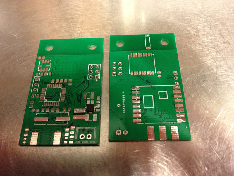

Hardware
The hardware consists of a custom PCB, a uBlox6G GPS receiver, an RFM22B transmitter, all controlled by an ATMega328.

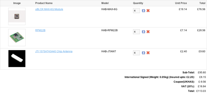

Parts Pricing
Upu's store
  • Zo'n €33,- per setje (gps+antenne, 434MHz zender)

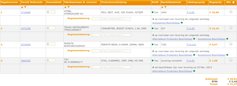

Farnell
  • Om van alles één te hebben is het ongeveer 7,87 euro.
