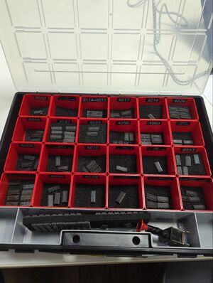

An opened Koffer.
This part is kinda irrelevant for now.

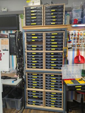

The main point of focus is the Tower of storage boxes.
  • The boxes used are the Allit EuroPlus Flex 37-17 Assortimentskoffer (picture).
  • Each Koffer is labelled which category of parts it contains.
  • Each Koffer has an internal configuration of storage parts (Inserts), which allows them to be modular. Inside the Koffer there are two sections.
    • main section: up to 4x6 individual 1x1 Inserts can be put, or Inserts with dimensions which are multitudes thereof.
    • front section: The front section of each Koffer is a fixed mold with two smaller compartments and a single wide compartment. Inserts do not apply to this section.
  • Koffers can be put at any location inside the Tower.
