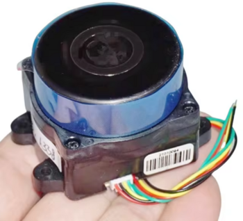

I bought an inexpensive lidar from AliExpress, no guarantees, no datasheets. This page is about understanding it and reverse engineering the protocol
Hardware
On Aliexpress: https://nl.aliexpress.com/item/1005007119470172.html and https://nl.aliexpress.com/item/1005007204489515.html
Has stickers with the following codes:
  • on the side of the plastic casing: data matrix HHCT3B6X9K00863
  • on the PCB: data matrix FW0251022426001437
  • next to the power/data connector: 2d bar code 20617158
Connecting a serial port:
  • green: 5V
  • yellow: TX
  • black: ground
  • red: RX
